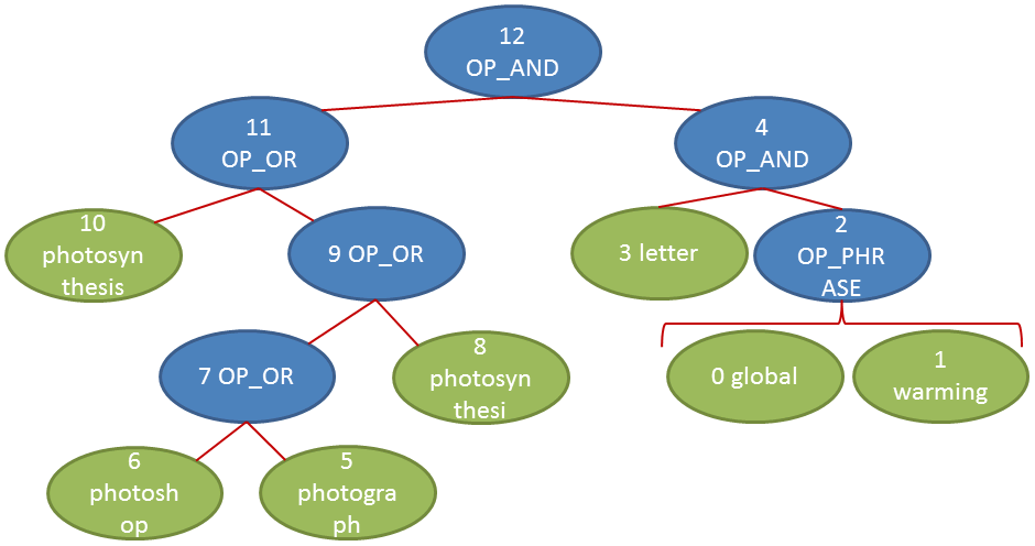

In the example Query Stack the two arguments to the OR operator on position 9 are:
  1. the term photosynthesi on position 8
  2. the expression consisting of the OR operator on position 7 with its two arguments on position 6 and 5
The complete query forms a logical tree, where the nodes are operators and the leaves the words.
Query tree
