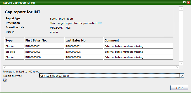

Production documents are always sorted by their external Bates number. Bates number ranges that are not covered by the produced documents are left empty.
If you later produce a document that has an external Bates number within such an empty range (also called Bates gap), the Bates gap is removed or reduced, and the document takes its correct place.
Tip: Administrators can view Bates gaps in CORE Administration.

They can only be filled by documents that have an external Bates number covered by the gaps.
The only exception is the gap before the first external Bates number. If there is a gap, e.g., from 1 to 100, and there is no document with external Bates number that fits into the gap, then it is possible to produce documents without external Bates number, starting with Bates number 1.
