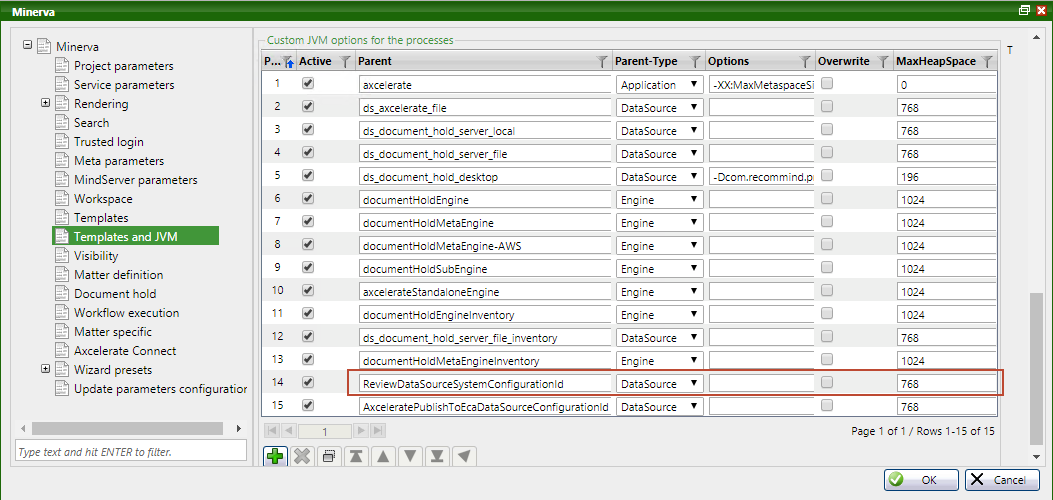

To configure the heap size according to your system,
In CORE Administration, open Axcelerate Ingestion application configuration in internal mode.
Tip: To open an item's configuration in internal mode, select it, hold SHIFT and click
. - In the Templates and JVM node, go to the Custom JVM options for the processes.
In the Parent column, find
entryReviewDataSourceSystemConfigurationIdand set the MaxHeapSpace to a size appropriate for your system. - Click OK and restart the Axcelerate Ingestion application.

To be able to configure a default maximum heap size for new data sources,
- In the Custom JVM options for the processes table, create a new row to add settings for
entryReviewDataSourceSystemConfigurationIdas you see in the figure above. - Scroll to the Publish datasource templates table located above the Custom JVM options for the processes table.
Create a row and add the settings for
entryReviewDataSourceSystemConfigurationIdas shown in the figure below.
