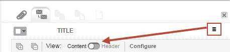

If both thread detection modes were enabled, you can toggle between the two modes in the Axcelerate Review & Analysis application. To do so:
- Open a thread in associated results view.
- Click the toolbar button to expand the view options.
- Use the toggle to switch between Content and Header view, selecting Content to display end of branch email.
Tip: If you do not see the View toggle, just one thread detection mode was enabled for the matter. You can identify the mode by opening the Search panel toolbar and clicking
to access the
Associations fly-in. The
Expansions area of the fly-in displays the enabled thread detection mode.
